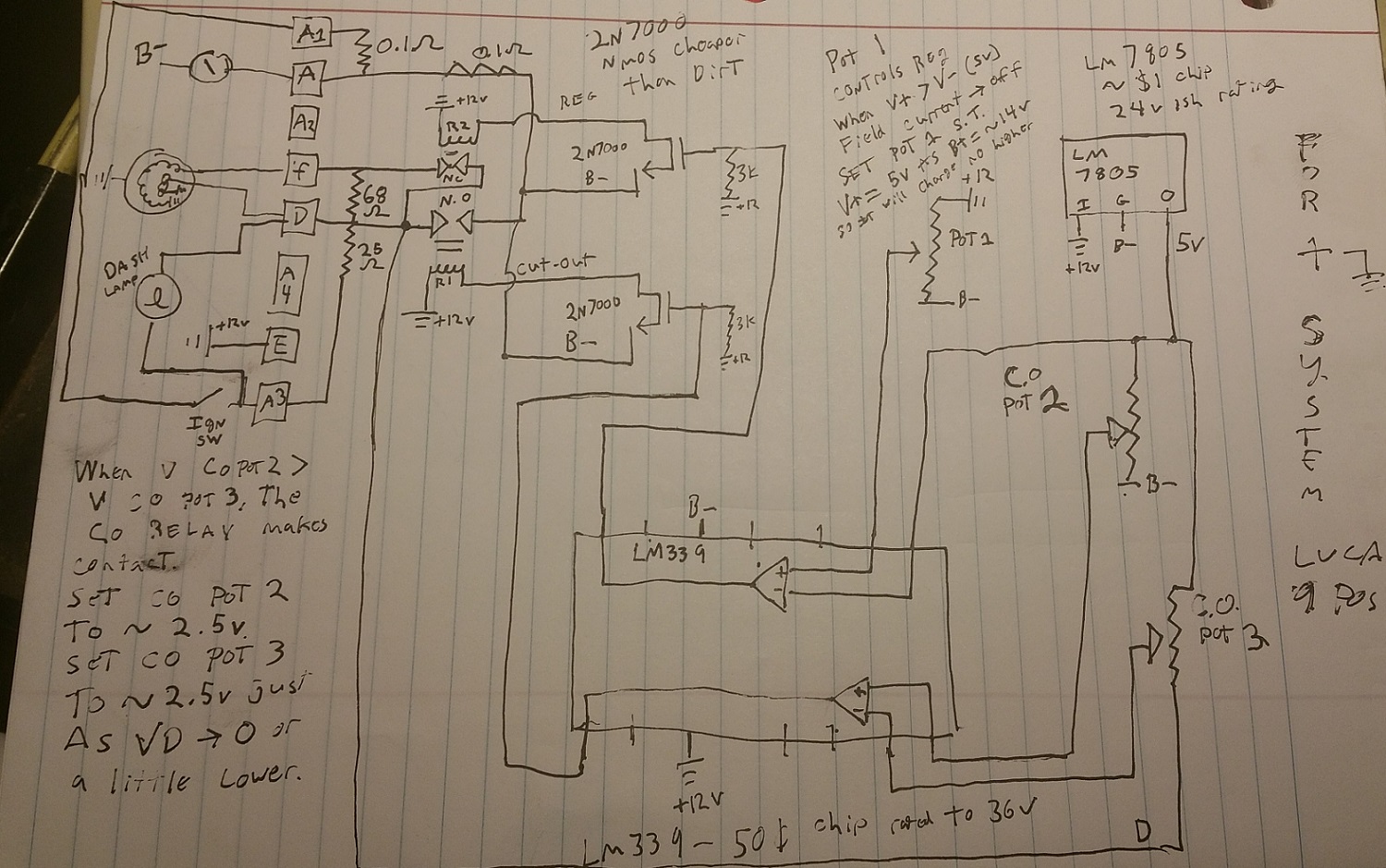

I was poured through the "documentation" about the regulator, and after doing a lot of experimentation- I was able to figure out how it works-- at least enough.
I designed a circuit, then simplified it, using a single inexpensive analog electric chip which monitors the output of the generator and can activate or de-activate relays depending on various conditions.
The above circuit was then modified such that it could be used on the positive ground system and monitor the negative voltages the car uses.
The circuit was then tweaked and made conveniently adjustable for battery voltage that it will regulate towards, drop in/drop out voltage of the cutout relay.

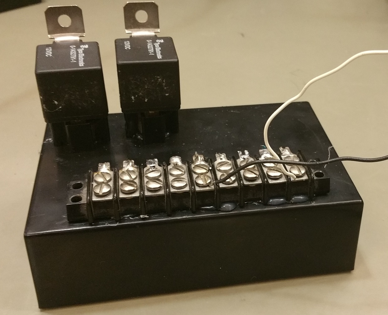

Presently my regulator uses two $3.95 auto relays (which are a little slow)- I might work now on a solid-state regulator with transistors-- which won't tick, or a faster relay (which will tick).
I then went and fixed what I thought was a horrible problem, that the dash Ign warning light- if it burns out will cause the car to not have electricity. This is no longer the case, but the ign warning light still works, and could now also be replaced with an LED, or a lower draw light bulb (like a 28 volt bulb for longer life)
The new circuit draws a lot less power than the original regulator, and is also significantly less expensive. My prototype has about $12 worth of electronics in it. In total, it is a complete drop-in replacement for the lucas unit, and is pin-for-pin compatible with the 9-terminal regulator as original.
I plan on continuing on the design of this all to make a regulator that works a little bit faster than my circuit does now. I am considering designing a PCB (printed circuit board), and possibly selling it.
I might make this as a simple bag of parts you solder up yourself style kit, or an assembled product. Currently, the amount of electronics used was small enough that it would be super easy to fit it in a housing styled to look like the original, but having that made would require a significant consumer interest for me to be able to do it, it would be expensive.
Anyway, I would like to gather the TA/TB/TC community's thoughts on the subject, and I will keep posting here about this project, and my TC as well as things move right along.
Here's my prototype (not in box yet) happily clicking away on video.
I had it configured to output ~9v here because my matco impact driver did not have enough oomph to make reasonable amounts of 12 v output on the generator.

- Posts: 2781
Re: 9 Terminal Lucas Regulator Replacement Project
Welcome, Kam. I applaud you efforts with this project and there are those who run solid state conversions. Personally, I am not one of them. The way I figure it is that the original control box when kept in regular use will last for decades. Case in point, I dug an old factory refurbished (early 1950's I believe) 9-post control box out of a closet and put it into my car 12 years ago. Still runs flawlessly!
If the mechanical control box gives you trouble, the car continues to run. With electronics you have multiple potential issues, including high heat, vibration and varying voltages in the system which aren't as gentle on electronic devices as they are on mechanical ones. And if the electronic item has an issue, you're dead in the fast lane with no chance of a speedy repair. If you know what you're doing, you can repair the original part on the side of the road with a screwdriver and a nail file, should it have a problem.
Where I see electronic parts having an advantage is on cars that aren't driven regularly. In this case, contact points can corrode and will require a bit of fiddling now and then to keep them running at their best. But if the car is kept more as a showpiece than a driver, then it probably doesn't matter anyway. I'm sure some will disagree with my views.
I don't want to dissuade you, rather quite the opposite. But I'm a bit of a luddite when it comes to old cars. I just like 'em old. My wife has a modern thing, in case I ever get tired of driving mechanical contraptions. (fat chance!)
Now if I WERE to go electronic, I would want it to look 100% original from the outside. Not that I'm a purist by any means, but I don't like looking at modern parts when I lift the bonnet even if I know they are in there. I have a few, but you'd never know it.
Do keep us updated on your progress. Nice to see fresh ideas on old machines.

Sorry to hear that and since most of the electrical stuff on TC2911 still has 1947 stamped on it, I feel it has served pretty well. Can't say the same for the throw away electronic junk on modern cars that takes a special code reader to diagnose and then cannot be fixed but must be replaced. You know I can rebuild my fuel pump or windshield washer motor, of if my regulator goes bad I can transplant the guts from a newer unit inside of it. I suspect that long after we are gone if some bright fellow can read a greasy thumb printed Bentley manual he will be able to figure out how to keep that TC running for a lot longer. There are still a lot of Model A's around and plenty of replacement parts. Probably won't be able to do that with a new Honda. Just sayn'."Lucas stuff horrifies me. I am de-lucasing the entire car."

By de-lucasing, for the most part I am running all new High voltage rated wire, adding fuses in a fuse box, going for a starter solenoid instead of the pull-cable arrangement, building a current-mirror circuit such that the ammeter will function as original but without all the electricity for the car and from the generator running through it.
Also, someone already did 80 percent of the work for me by simply chopping through all the wires when they took this car apart. With a hacksaw. The only original parts I have remaining are the coil, the corroded regulator, two rotary switches, and the dash instrumentation.
I think it goes without saying that the electrical system has a few flaws. Off the top of my head these are ones I can think of:
Unfused electric lines running long distances.
Horn - 10-15 amps, Headlight - 10 amps are powered directly through the switches on the dash. As are components connected to the ignition keyswitch.
The incandescent dash lights are regulated with a wirewound resistor- Instead of using a higher voltage bulb.
Most of my planned improvements center around countering these issues with fuses, relays, and better wire.
What I am not doing is making my entire car run off of a microcontroller.
That brings me to what I noticed on the solid-state controller box. First of all, it appears to cost about as much as the original regulator. It also appears to be using an arduino microcontroller that is powered off of ~5v. This kind of electrical device, admittedly, would not be particularly compliant to changing voltages.
I don't think I would ever do it that way, for a number of reasons.
1- parts cost.
2- Arduinos are not very well known for their reliability in the ultra-long term
3- it doesn't look adjustable
4- if I were to suspect, the Arduino is using ADC's to sample the voltages in the car, and then making the mosfets change state accordingly in some sort of P-I-D control (or maybe just P). While this would surely work, it is unnecessarily complicated.
I'm not really looking to make a huge ammount of money for myself, I mostly do this for fun. For anyone that likes this sort of thing, i've put my annotated schematic up to show how I made this thing work with two relays and $15 or less worth of parts.
1- parts cost.

Neat use of a transistor to shunt field current around the contacts instead of through them. How delightful. I might try that fix on my RB-95 to see how well it works and leave it be.
