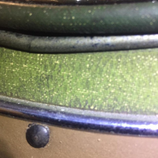

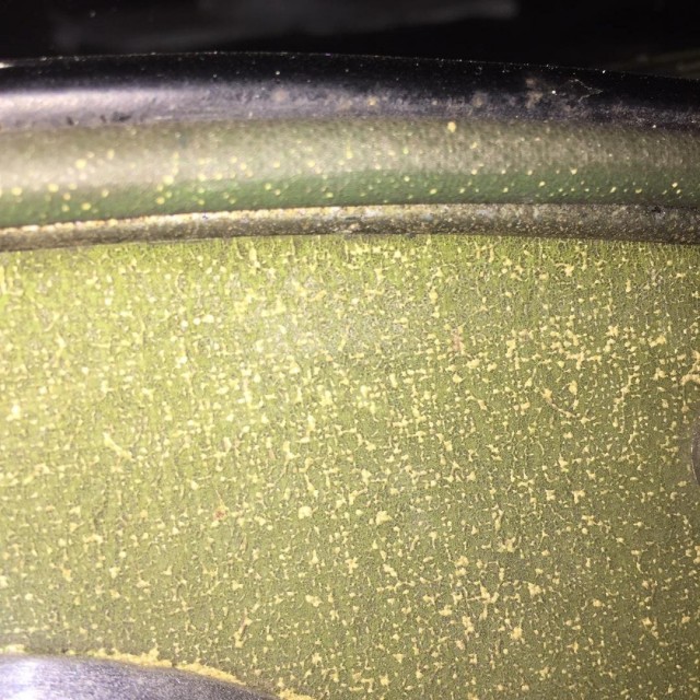

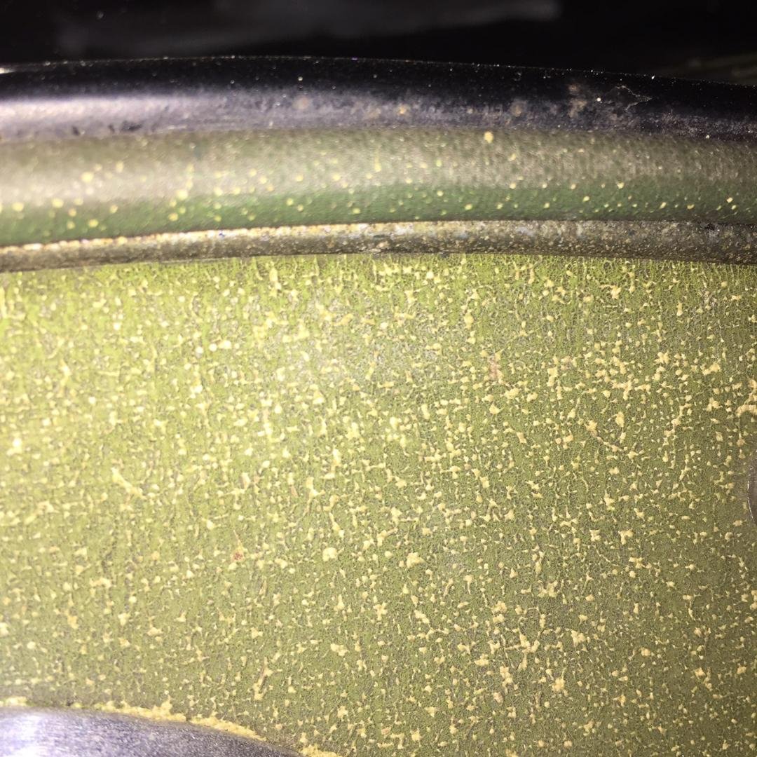

TC's never used anything but the plain woven type rexine on the dash. TC9866 retains the original rexine dash. Hard to get a good pic, but it more resembles a very lightweight canvas. I would be inclined to look into cotton canvas, wash it and dry it, and then "paint" it. Something like 7oz regular square weave canvas, unless you could find something a bit finer. https://www.bigduckcanvas.com/7-oz-duck ... -the-yard/

That looks exactly like the Rexine on my Y-Type, even the color. I suspect all the early post-war cars used the same stuff, and likely the pre-wars also.
