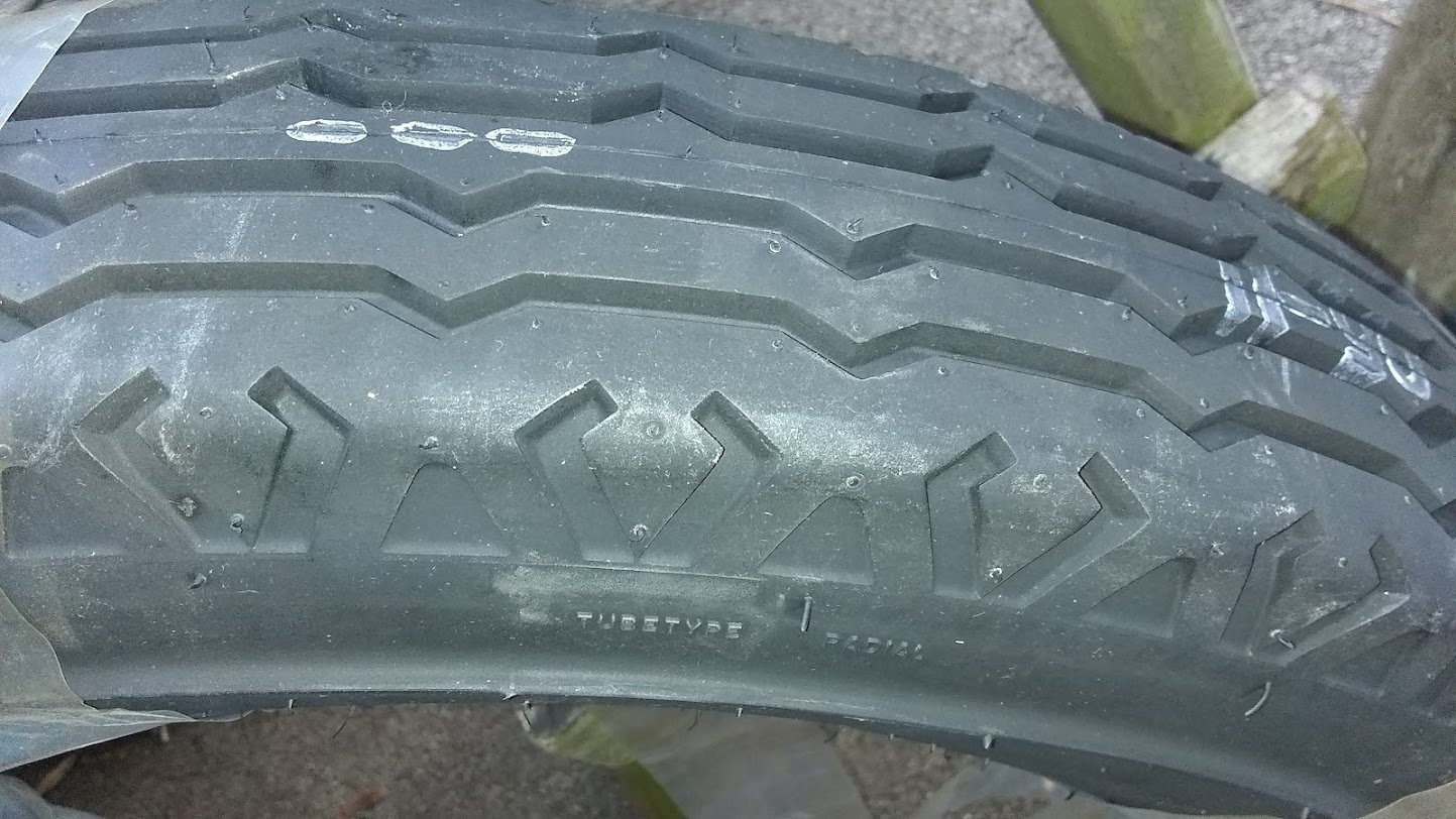

Re: TC tyres
I have just fitted 5 new wheels with Waymaster tyres. I asked around before getting the tyres and had differing opinions. I was influenced by the suggestion that Blockley were good but gave a hard ride on a car like the TC with limited suspension. Apparently Waymaster are good if you enjoy some gentle drifting. Since fitting the tyres I have been told that Waymaster squeals on corners. Seems I might regret believing Waymaster marketing.
(The car is not on the road yet).
