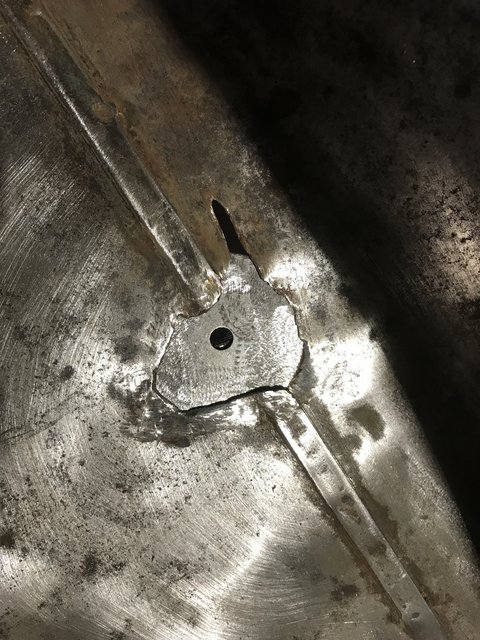

That's interesting, Mark. Thanks for posting. I have welded a large washer over the damage hole in my rear wing (held in place with a magnet)and filled in the small hole (not shown) but not sure yet where the mounting hole needs to be. The new inner wings have no holes and the old wings have numerous incorrect ones but I have a good idea where they should go.

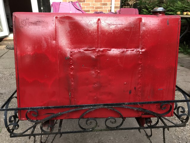

The problem is that I need to make a decision about my petrol tank. It has been opened up, something inserted, then welded up again so it only holds 10 gallons now!
I must either cut it open again and remove whatever is in there or buy a new tank. I am not that confident with my welding to guarantee a leak proof seal so may need to get our local black smith to do the welding. Ideally it will be gas welded but I only have an old mig welder which is temperamental at best.

wow that tank has been played with hasn't it ... it bit too much for my liking! You'll have to make the call to whether its ever going to last, even if it doesnt leak now! I'd also question that tank is going to be square enough or flat enough to show NO distortion?
May be a good idea to get another and or new replacement one
Re: Rear wings and tank fitting.
Hi Chris. The car was used in competition in Australia (it was dismantled in 1960). I understand the idea was to reduce the amount of fuel sloshing around. Until I open it up I don't know what is in there...
