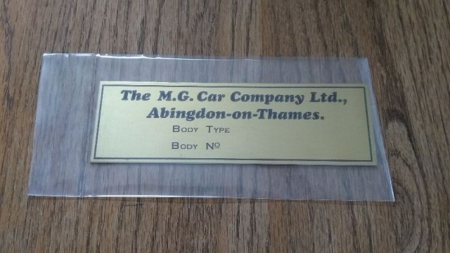

Re: TA Body Number ID Plate or Tag
Here's what From the Frame Up sent me.
It measures 4-7/8" x 1-1/2".
Perhaps they make them without holes because they were used on various models with two or four holes?
It looks like the pix of some that others have sent me.
I will be interested to see if Ian has something.

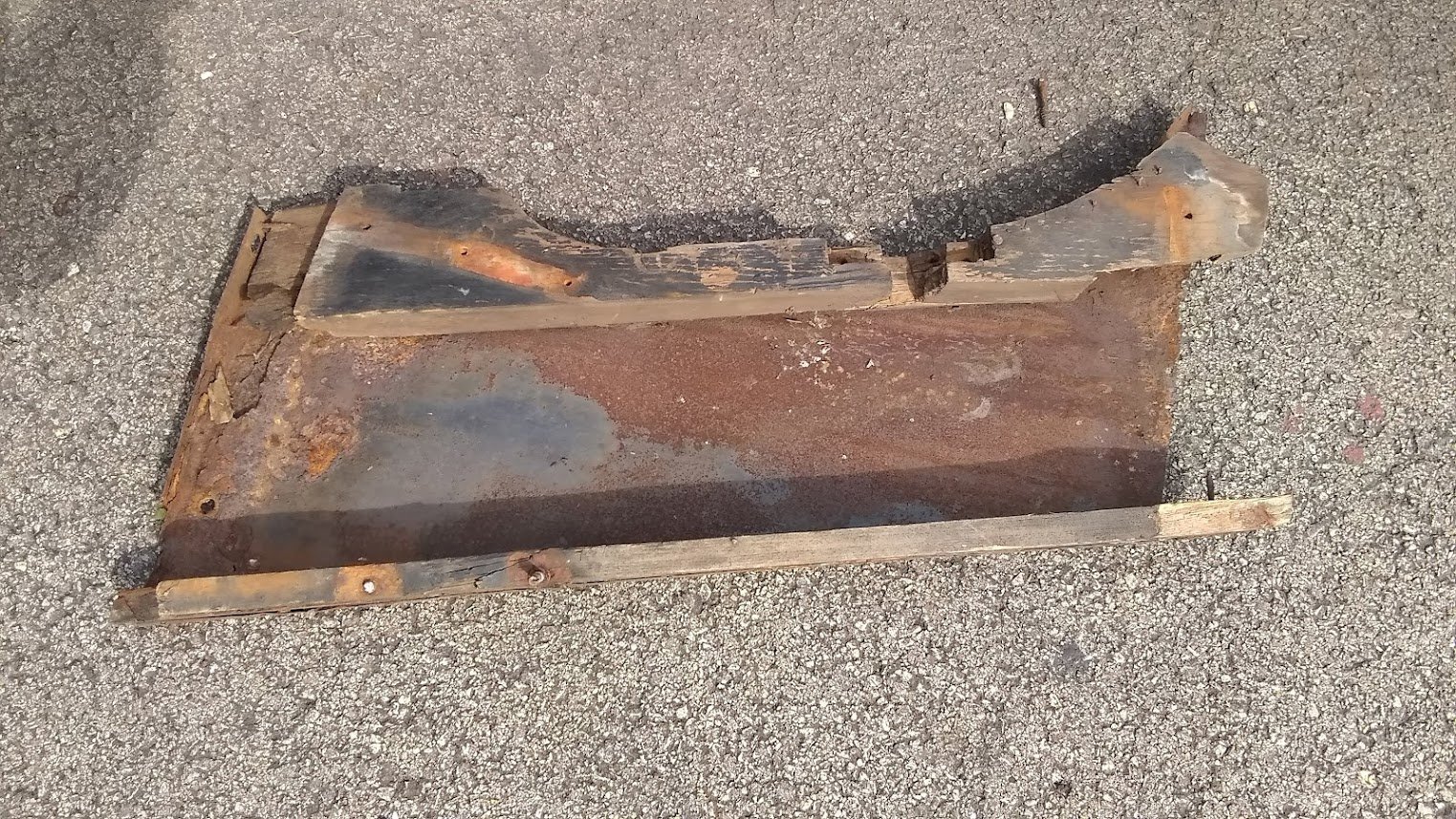

Meanwhile I started stripping my left front side cowl panel, where the ID plate in theory should have been. Found the car must have taken a clout there at some time in the distant past, and had been repaired by someone who drilled 8 holes through the wood and put in long 1/4" flat head screws, then covered them with about 4 pounds of lead. The steel rusted away but the lead remained.
This panel is separate from the door sill panel on this TA, apparently unlike the TC, in which the Moss catalogue shows it as a one piece quarter panel 457-300. I'm not sure yet how they were joined, either by a couple of tack welds and then solder, or maybe just solder, anyway it broke apart.
