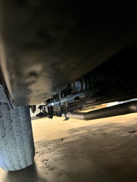

Hello all,
I have TC 6515, late 1948 production, and it has a grease fitting on both sides to grease the rear spring where it attaches to the chassis. I had a 1949 and 1947 and do not recall this on either one. Was this standard for TC's and my other two simply lost the whole grease fitting and tubing to the spring ?
Thanks
Mike

Post by Steve Simmons » Tue Jul 12, 2022 12:54 pm
Hard to see but that looks like the greaser for the hand brake cable. They are often removed when aftermarket cables are installed, which have nipples installed directly on the cable housing. They do the same thing, but the originals don't require you to crawl under the car.

Post by bloodysalmon » Thu Jul 14, 2022 6:33 am
May I just comment to the fact that these pipes are NOT greasing nipples but are indeed oiling nipples!
The mistake has been done many a time and thats why they glue-up and are inaffective. Oil not grease ... throw back from theTriple-m MG's like my D-type and F-types.
The old ones may look like grease but its just old mineral oil semi-disintergrating.
Yes they will leak and drip so be warned. Try using a good nipple connection on the pump which can force the all the way ... before it decides to return another day. :thumbs:

Post by antijam » Fri Jul 15, 2022 2:57 am
The TC lubrication chart recommends Duckhams "ZNOL" KG grease as the handbrake cable lubricant.
I don't know what the modern equivalent is but I'm presuming it's a light grease.

Re: Grease fitting that I have not seen before
Post by bimmrr » Fri Jul 15, 2022 10:58 am
