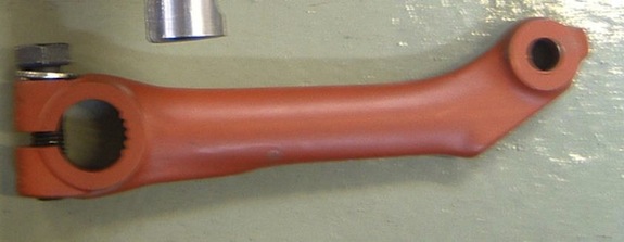

Post by Duncan M » Sat Mar 19, 2016 12:19 pm
Jim-
Be sure and completely remove the pinch bolt ( you say you can loosen the nut) prior to removal of the pitman arm. Yes, use a puller unless it will pull off by hand. The pinch bolt acts as a safety, in case the nut loosens or falls off. The arm will not come off with the bolt in place, as the sector shaft has a groove. See pic of VW arm below from this article: http://ttypes.org/ttt2/some-after-marke ... onversions and another pic

Thanks for the help. I talked to the person who restored the car many years ago and he said that it is a very early Datsun box from Australia and has only one bolt on the splined shaft. He stated that I should used a puller and it should come off. Here's hoping....Jim
