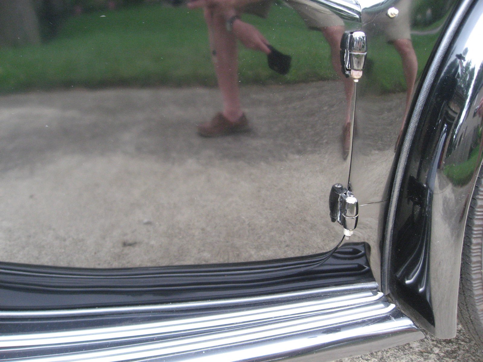

Like this..........

It looks like there is a gap. Does that car have a chrome wrap finish?

Post by stephen stierman » Thu Jun 22, 2023 11:34 am
Ray, if you mean does the piping have a chrome wrap finish? Absolutely not, it is black, and you are seeing reflection. Yes, there is a gap and I believe that to be the way they were done.

Not the piping. The paintwork is so reflective I thought it might have been a chrome finish.

Oh that.......just good old acrylic lacquer, no base coat clear, fancy urethane, etc. Shot out in my drive way piece by piece, hand sanded and buffed.......

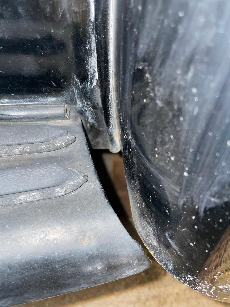

Wow. Running the piping across the gap? Seriously? That makes no sense and looks foolish.
Here is how the factory did it in October 1949-

Perhaps it is just the photo, Duncan...but it looks like the rear wing is sticking out proud of the running board. I would have expected them to be in exact alignment.

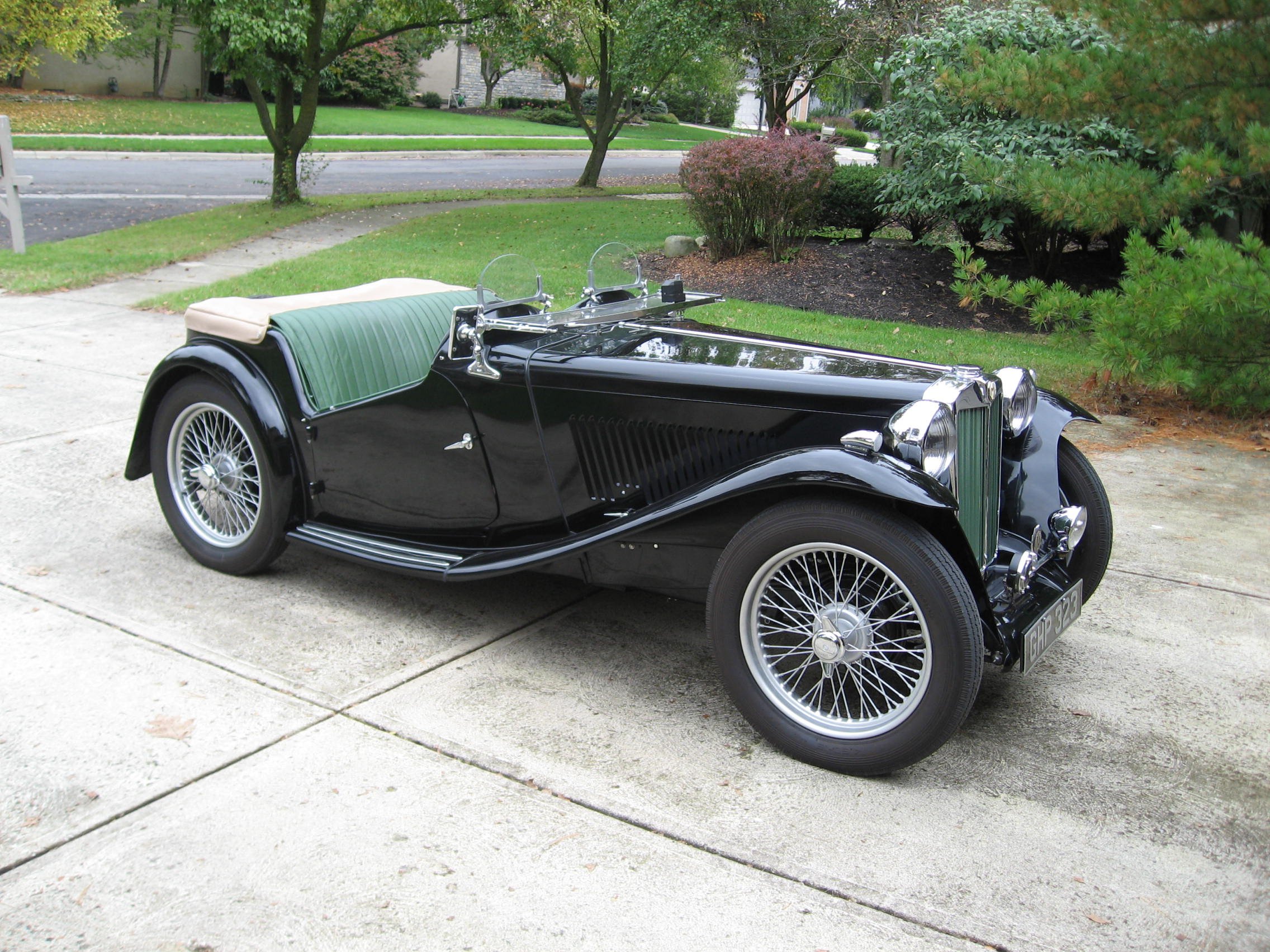

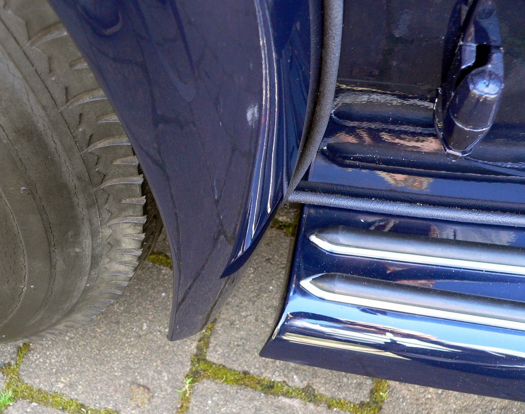

The front wing and running board are perfectly aligned and contoured together, but they are joined together and continuous.
The rear of the running board on a TC does not join with the rear wing, so there is no reason for the outer edges to be in any sort of alignment. But, many rear wings you see on TC's have been cut down on the outer edge, or are part of full reproduction bodies. Maybe the reproduction units have running boards wider at the rear?
Original (late) rear TC wings "stick out" a full inch. Reproduction rear wings have never been accurate in shape or finish. By now we see a lot of reproduction wings based on earlier (wrong) reproduction wings....
