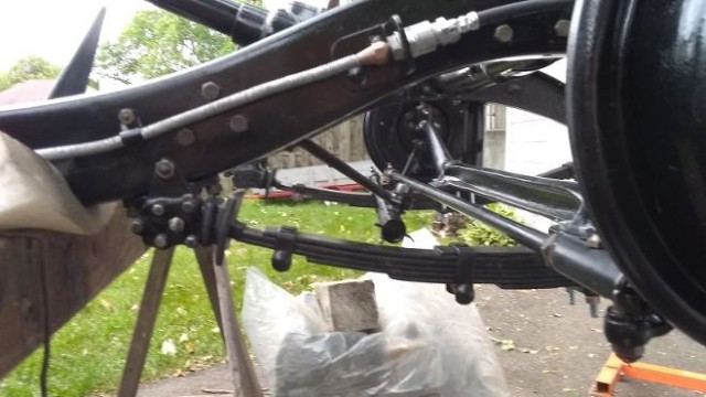

Re: Lowering TC?
Will, not sure what your problem might be. Pictures are always helpful to determine what you are dealing with. Use lower resolution settings to be able to load onto this website.
TC with BC box and all the correct and standard plumbing should give you right around 7/8" clearance. Note the blue ear plug showing gap at straight ahead. The earplug just compressed a small amount, just enough to hold it in there. Maybe you have a different box or the steering drop arm designed for use with one of the other boxes?
Re: Lowering TC?
With the correct rod end assy there might be clearance so time to pull the drop arm, get it nde tested, and try the correct joint, but the prices are nuts!
Center to center distance of my drop arm is about 5 1/4" so if anyone can check theirs I can compare.
Sorry if the pic comes through upside down. Don,t know why that happens bur the car did come from Oz.
And ignore the welded on sump fins as that might be another story.
Looking at parts list drawings seems to show the drag link on top of the drop arm rather than suspended underneath.
What is correct?
Thanks.
