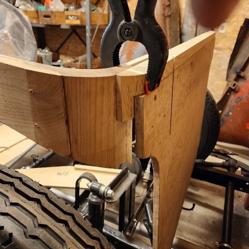

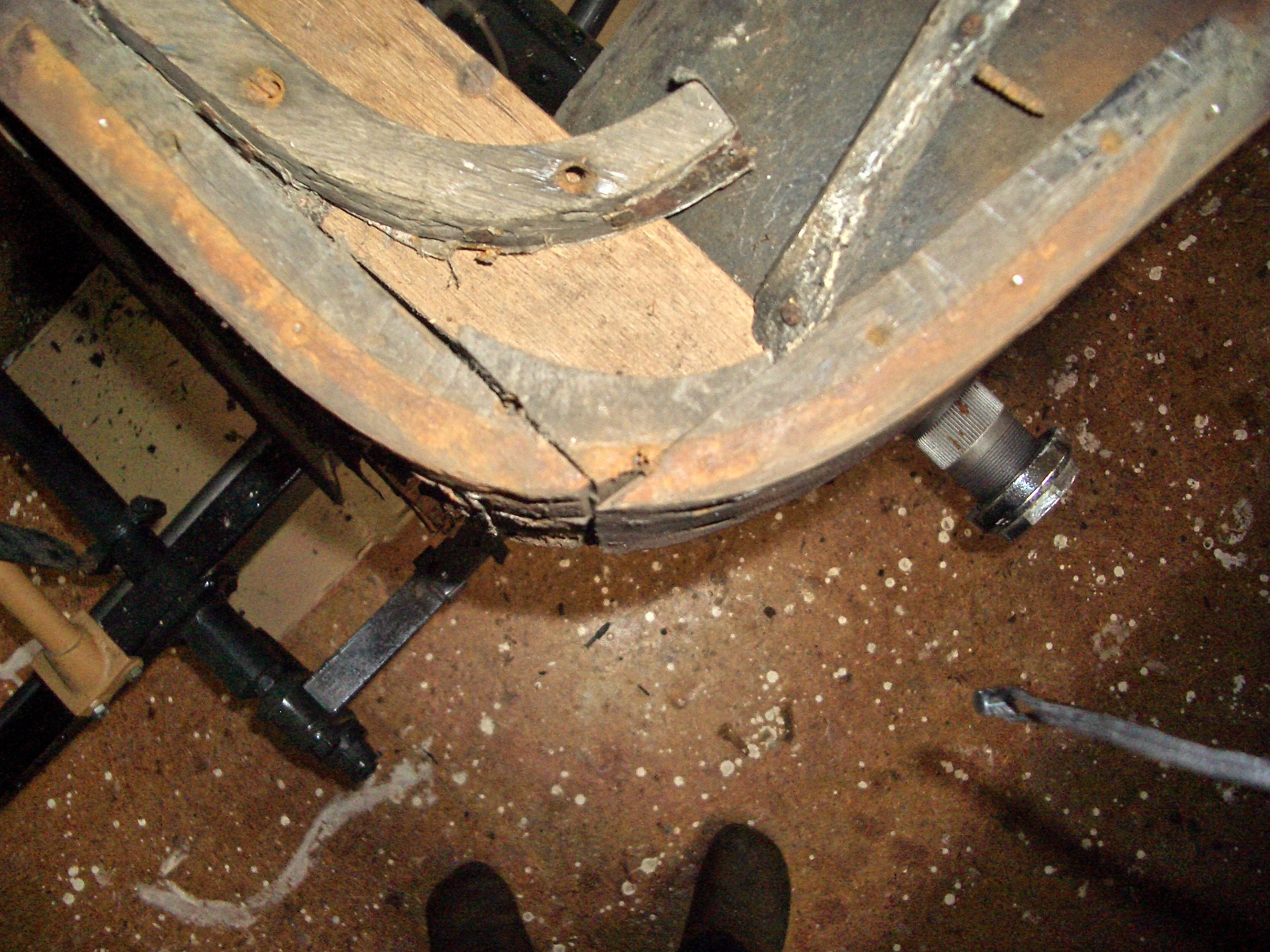

Specifically, I'm wondering if this rear corner is right. The overlap looks strange.

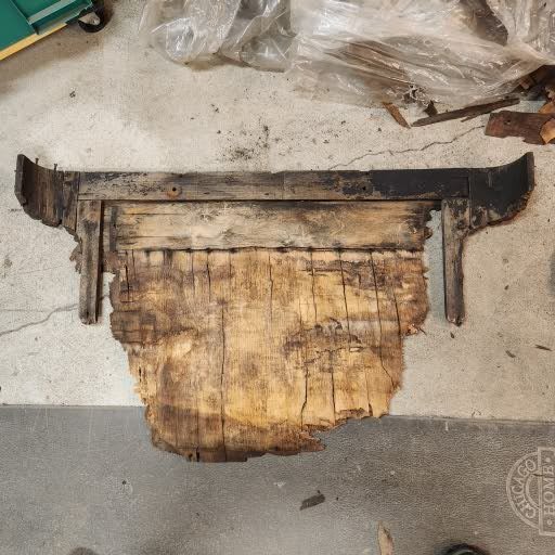

My original wood was mostly rotted away so I don't have a lot to go on.
Second, there are a lot of holes in the back board I don't understand.
Most of my other parts are ink stamped TA, but the back board was not labeled by the vendor, that's why I'm wondering if it could be for a TC instead of a narrow late TA.My original wood was mostly rotted away so I don't have a lot to go on.

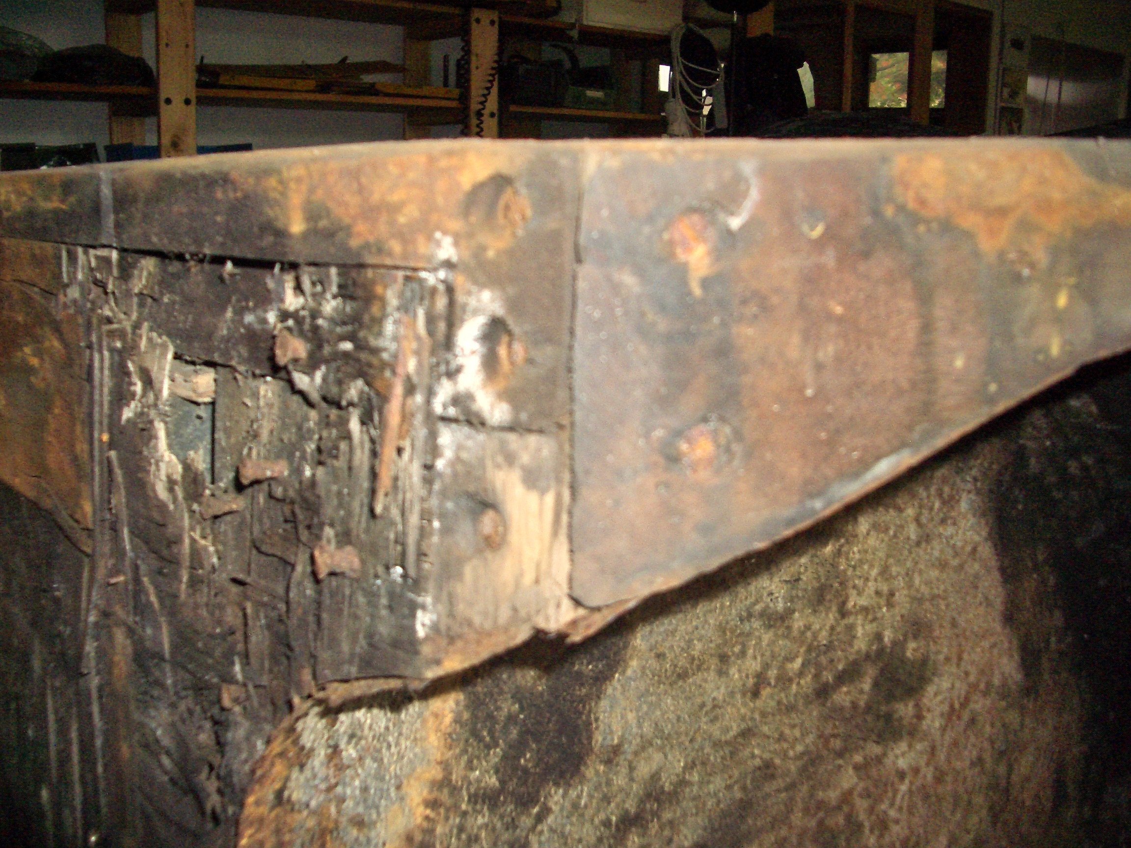

Re: TA Body Tub Timber Construction Pictures
Here are photos from that area on a totally original (as far as I know) TC body. I passed this body along last year so unfortunately I can't get any more photos of it but maybe these will help?

This pic shows what I don't understand. Why does the back board hang out beyond the curve in the top rail? This is why I'm wondering if one or the other of the pieces could be wrong.

Doug at Frame Up says the wood is TA, and the back board is made purposely too long, and when the corner construction is finished, to take a belt sander and finish off the protruding edge.
Here is what I have.
I don't understand why there is a 3/4" gap between the rear corner piece and the back board.
The curves don't match either.

Well, I'm starting to figure it out.
The top back rail from Frame Up is definitely wrong.
There should not be a curve at the ends. They should be straight cuts.
The fillet pieces are wrong too.
I don't know yet about the back board. There was not enough left of my old one to determine how it was supposed to be fastened to the rear corner pieces.

I dug out my old rotted pieces and started to glue them together, so I can maybe get an idea of dimensions. The back board is missing about the lower 6 or 8 inches, but I can maybe get a top width.
The top rail is mostly there.
And I have the remains of the side fillet pieces. They are solid planks, not plywood.
My old rotted top rail is 38-1/2" long, or wide as it would be installed on the car.
There are rabbet or dado cuts at the ends, to overlap the rear corner pieces, which the TC rail does not have.
My old back board is approximately 38" wide. The left end is missing, but I can estimate it by measuring from the center line.
