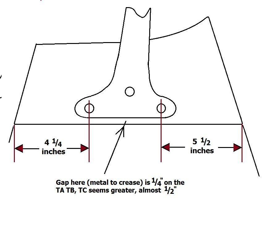

I noted with interest Mike Sherrell's notes on page 215 of TCs Forever, that the bottom two holes for the cowl brackets are "about 3/8" on average" above the scuttle fold line.
Has anyone taken measurements for these holes from the front and back of the scuttle? Gene's car has an aluminum tub built in the UK back in the late 70s, and it does not have any holes for the windscreen cowl brackets. I hope to take some measurements from Gene's other TC tub when I pick up the car, but I thought I would also ask the TC brain trust for additional data points (especially those with currently disassembled cars).

Assuming you already have a windscreen complete (they are expensive things!) your best bet is to offer it up to the cowl. The shape of the side brackets and the cowl itself will determine the best position. Brackets do vary (and TD ones are not the same) and of course your Ali cowl might not be the same shape as an original. The important point is that the brackets' bottom edge is exactly parallel to the fold line. There is an L-shaped piece inside the door panel for the machine screws holding the lock, but I cannot be sure about the W/S screws as TC0978 does not have one fitted (only Aeroscreens)

Here are a couple items I provided from previous posts (could have been on the other TABC forum) that should help you.
TC0273, TC0279, TC2040
