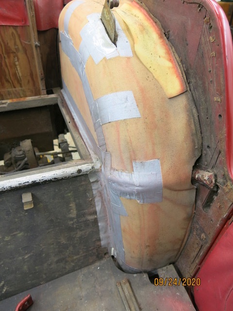

When taking apart TC6984 I found this sound deadening which I thought might be original- later I realized this car had it's rear section replaced as the back wooded panel of the side curtain box had rotten out. Not sure if this is correct of not but I plan to put a more modern sound deadening material with an adhesive backing over the rear wheel arches.
Bryan.
