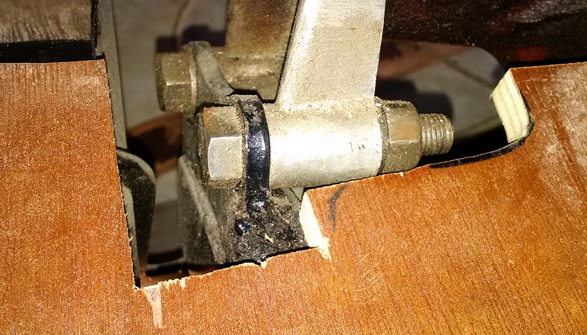

Can you get the gearbox mounting bolts out with the floor in place?
Just made my floors and unless I make huge cut outs to allow the bolts to come out I will have to remove the floor.
When installing I had the mountings ftted to the GB but because the side going onto the chassis is at an angle I could not get it fitted. Had to first mount the mountings to the car and then to the GB.
So it seems weather you going to do it via the front or the back the floor boards need to come out
I am now considering the bigger cut outs and fitting a cover plate using the same material as used for the brake fluid hole in the floor.

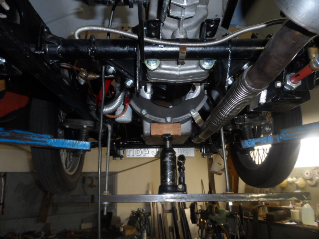

Re: TC transmission removal
Hi,
that is the jig I made to remove the Gearbox with engine still insitu - you can lift the engine on the cluth side
and pull the gearbox 100 mm backwards to free the input shaft from the cluth and than you can lift the gearbox
out of the chassis.
Carl
out of the chassis.
Carl
