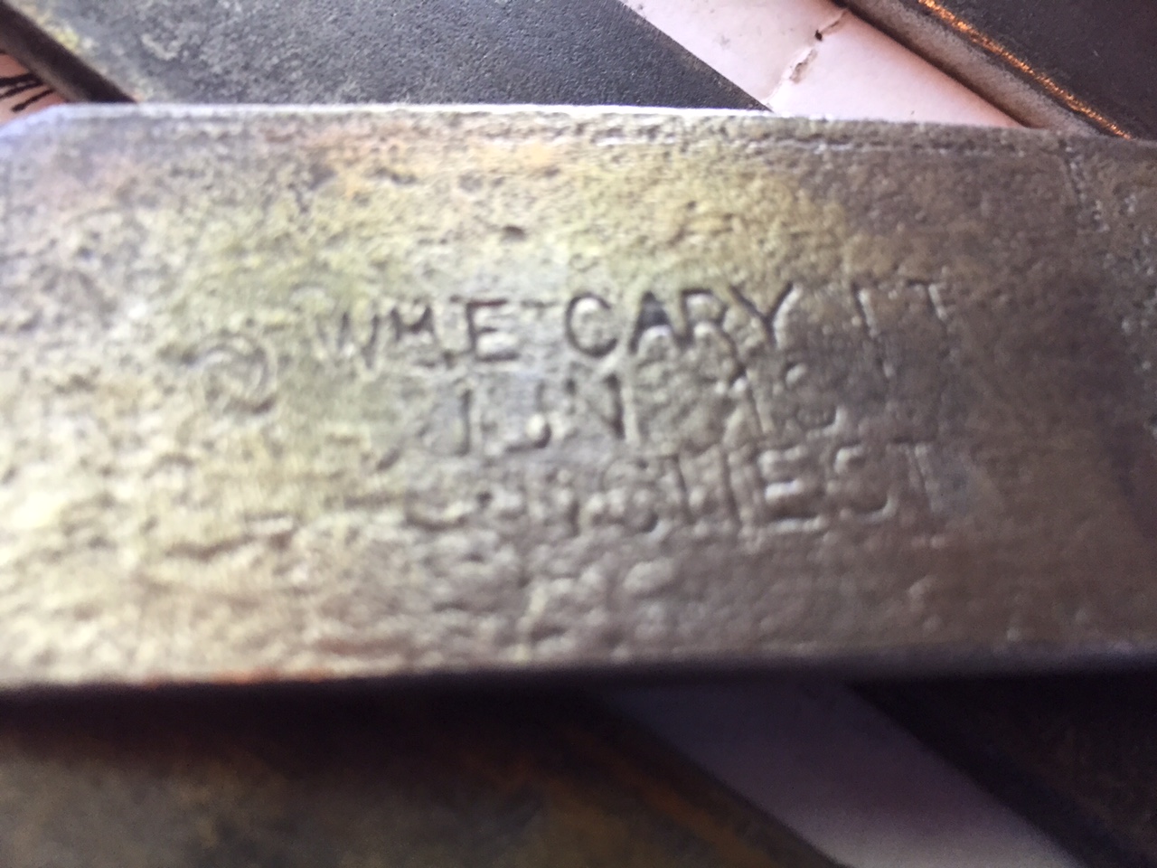

I've separated and cleaned the leafs . They've never been painted just graphite grease. seem to be the originals . They were encased in gaiters not leather . Are these markings of any significance or just the shop where they were forged?

Can you make out the June manufacturer year stamped in there? Could be the key puzzle piece. Cary did make the rear springs and front coil springs for TD's. TC's are stamped with a typical 5 digitpart number and "Berry" for Brockhouse Berry of Manchester. They were the original TC spring supplier I believe. see: http://ttypes.org/ttt2/leaving-your-mar ... -tradition It would be interesting if TD rear springs would work as-is in a TC. I never heard that one, or maybe they were re-worked somehow?
What sort of gaitors? The factory springs definitely would have been painted originally, as no gaitor's of any sort was provided. If just teflon liner and graphite dust used, what will happen when moisture gets in? Or were you going to use gaitor's to avoid that?

These are front shocks . The gaiters seem to be black canvas .
