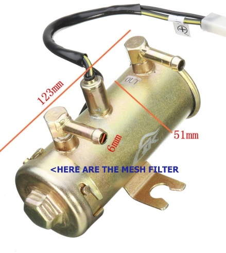

I agree with you filter before the pump save the cleaning of the pump and carbs BUT NOTE
that clogging filter can stop the fuel -and SU pump are very sensitive to working dray -it can have serious problem-filter must be frequently Controled
FACET normally have before a mesh filter that can stop the large debris only

today i become my new su fuel pump
and the fuel filter
https://www.ebay.de/itm/Wasserabscheide ... m570.l1313
a realy heavy fine part
tomorrow i first replace the fuel pump and take a ride with the car, then i will look forward

So today i have a little time
i put the new su fule pump in the car, but it doesn t work as it schoud
a freind of mine came to help
we took a flexible gasoline hose put it directly to the pump and then in the tank
than it works perfekt
so it must be a hole or somethinng else from the end of the car to the fuel pump
from the back the two hose go to the middle of the car, there i find a 3 way tap from there only one goes up to the pump , but not straigt on it goes in a wavy line, never seen this before.
so i will make it new from the back to the front
there i will place this here
https://www.wellenshop.de/dreiwegehahn- ... -anschluss
so it looks like the original ...
from this part it will gi to this one
https://www.wellenshop.de/kraftstofffil ... ssenborder
and than to the fuel pump
