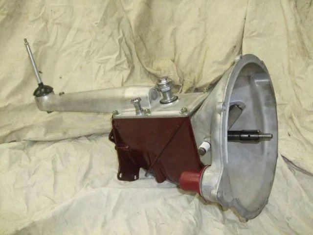

The easiest way to tell the difference is by the aluminum extension on top. Here are photos of TA (found on the web) and TC.
No experience with 5-speed in a TA, sorry!
- MG TC Gearbox
- tc-gearbox.jpg (57.24 KiB) Viewed 6905 times
- MG TA Gearbox
- ta-gearbox.jpg (48.82 KiB) Viewed 6905 times

Thank you Steve. I’ll have to take a look and see which box is in the car. Appreciate the pics.
