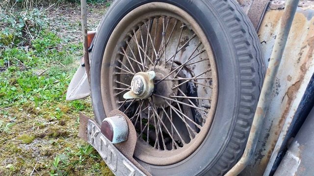

Click see it "HERE" if not facebooking. Doesn't look as bad in daylight. Not at all. Those tail lights are sure ugly, but the folk-art luggage rack makes up for them, sort of. Wheels look quite salvageable, which I have found often means a lot of other things will be, also.
If the owner is so inclined, that is. Looks like an excellent project. I still think that is an EXU steering wheel. Have fun! here is 2 of those pics from frenchblatter's site:

The wheel will be changed for a four spoke original design. The car was first registered in the UK .
Funny, I ordered a spoke spanner last night so I can refurb the wheels when (if) I'm waiting for parts. I'll remove one spoke at a time, clean down to bare metal and refit spoke. Carb kits are on the way. Other than enquiring about prices/services that's all I've done so far. I'll have it stripped to a bare chassis by the wekend, then the parts can be ordered.

I bet you are going to have a hard time, loosening those rusty spokes!
As these are new availble, I would cut the spokes and replace them with new ones, which you do not have to chrome or paint, whatever you choose, etc!

Norman- I only broke about 4 spokes per wheel, while trying to get the nipples off wheels that had sat close to 60 years. After soaking in PBBlaster about a month, I carefully cleaned the threads (inside and out) on the oldies, one at a time, and applied a thin layer of the thick silver/grey thread dressing. I decided against heat. After truing and runout adjustments, etc. I sandblasted each wheel assembly down to metal and promptly repainted with a high quality multi part auto sealant/paint. The wheels are the only thing I have sandblasted, and it is highly recommended for complete and "trued" wire wheels. Of course, your way will work too. Have fun!

That wire wheel article was right on this site. http://www.mg-tabc.org/library/wires.htm
The truing of wheel part is towards the bottom. The first part is all about cutting out the old spokes, then how to lace them, etc. I found the truing part helpful. My stand is different than his. It stands upright, the spindle/hub parallel to ground, so wheel upright when truing. But, I think you have at least a month of penetrant soaking before you will want such a device.

I'm going to bead blast the very rusty bits but I'm told they aren't that bad. Car will be here about 0930 in the morning and I will soak it all in muk-off and then jet wassh before putting it in the workshop (dirty cars not allowed in workshop)
The wheel refurb will be done when I'm stuck waiting for parts as will the rubbing down of the panels.
I'm going to strip to a bare chassis then overhaul each bit and refit it. So chassis down to bare metal and paint with POR15, then front axle and then rear axle after opening diff for examination. Then the brake back plates and the cylinders. The engine and gearbox will be stripped and rebuilt with whatever's needed (pistons, valves, guides at least) Probably need new bearings in the gearbox but maybe also synchro hubs.
